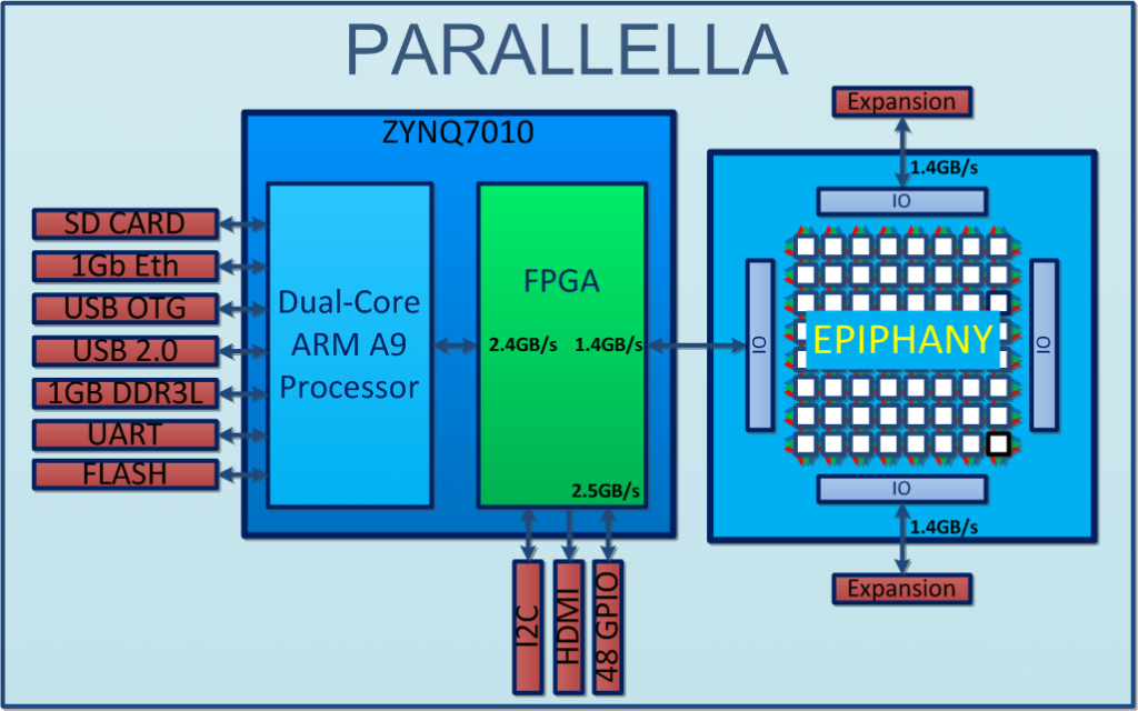

This board is interesting in part because it has an array of parallel CPUs on it, but also it has dual-core ARM and a 32-bit-wide DDR3 RAM, on a chip with FPGA capability (the Zynq7010) - so could be a suitable platform for tinkering with CPU designs.
Presently available to those who sponsored the kickstarter but intended to be $99 retail. Perhaps late this year?
Parallella Overview
Quote:
Zynq-7020 Dual-core ARM A9 CPU
Epiphany Multicore Accelerator (16 or 64 cores)
1GB SDRAM
MicroSD Card
USB 2.0 (two)
Four expansion connectors
Ethernet 10/100/1000
HDMI connection
Ships with Ubuntu OS
Ships with free open source Epiphany development tools that include C compiler, multicore debugger, Eclipse IDE, OpenCL SDK/compiler, and run time libraries.
Dimensions are 3.4” x 2.1”
via https://news.ycombinator.com/item?id=5557985
