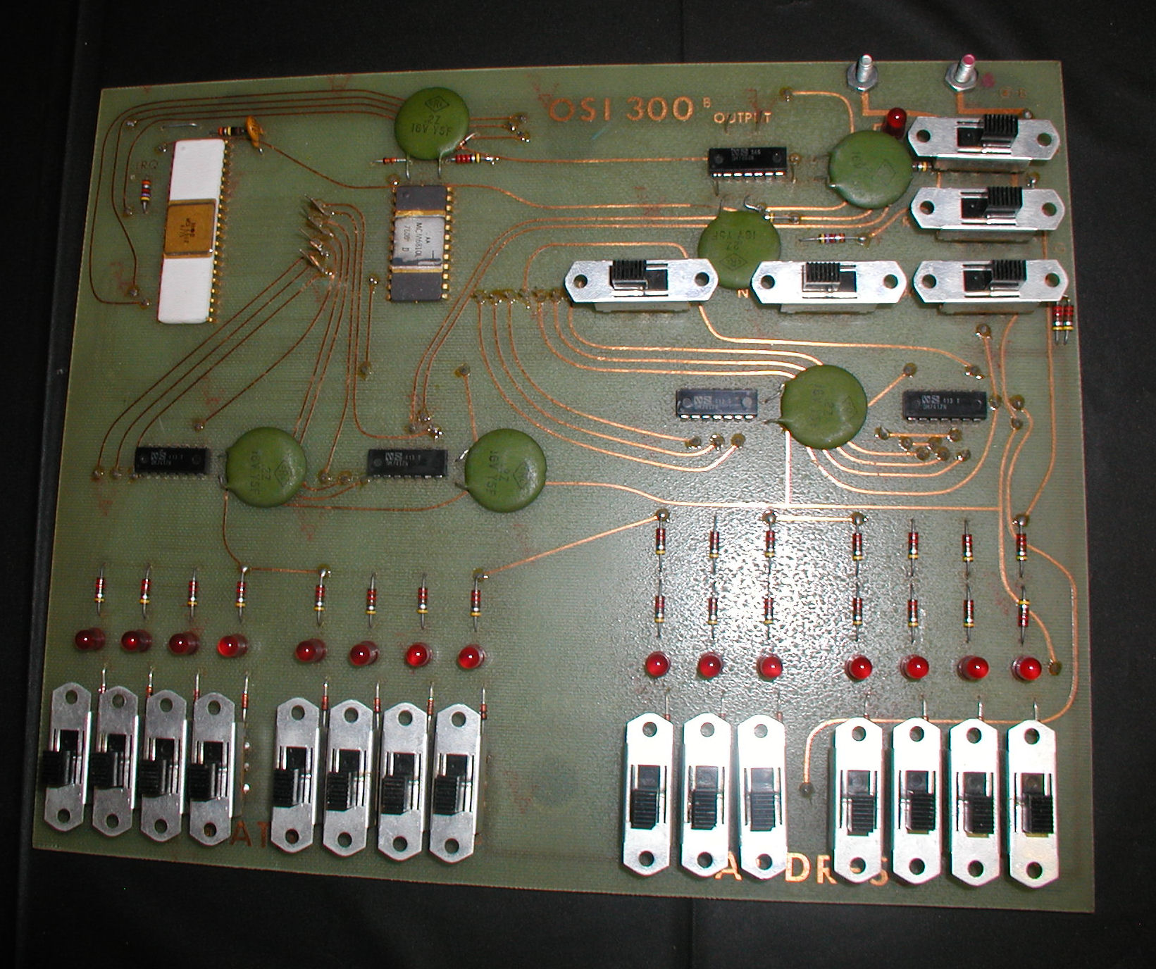

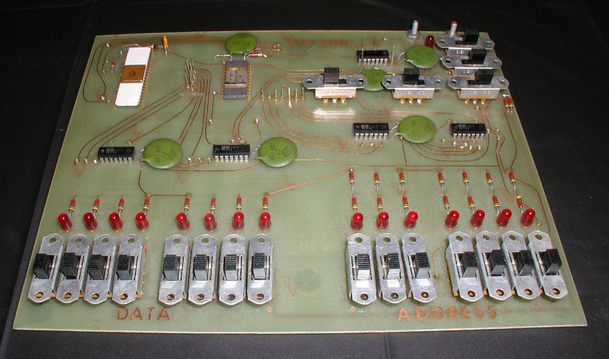

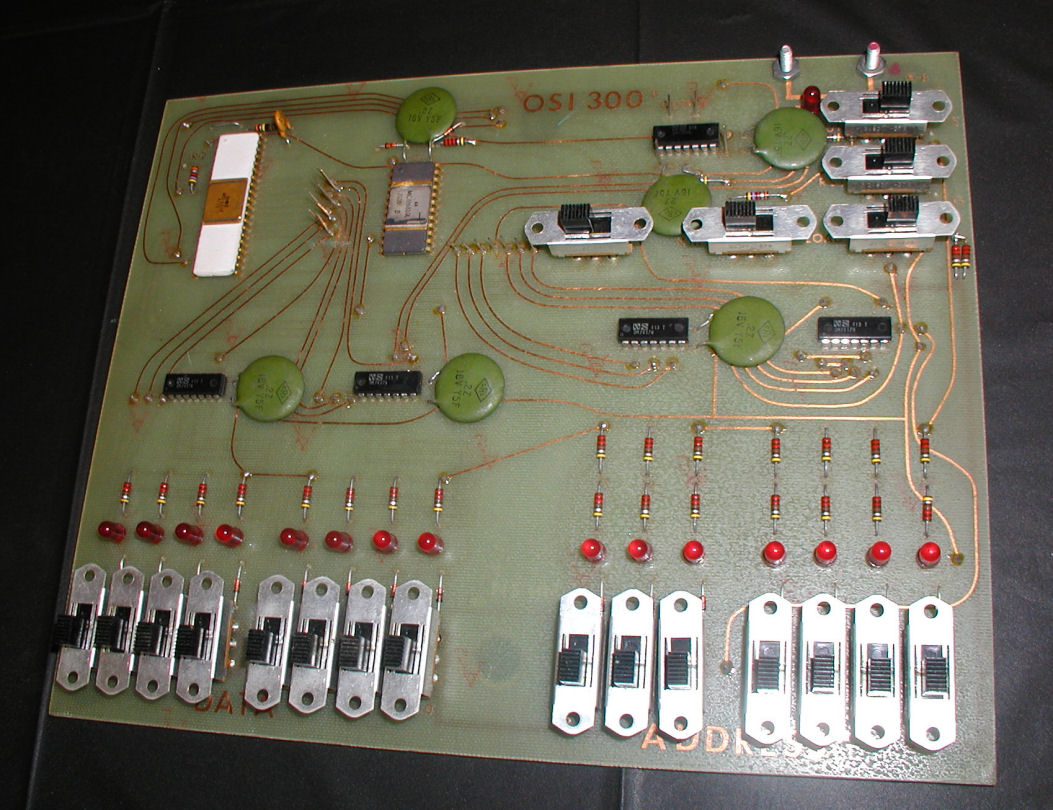

Does anyone know or have the schematic for OSI Model 300 micro? I sort of searcahed ..found manuals and info but no circuit diagram.. interested in being able to mimic it.. :mrgreen:

It'll be worth posting this question to the 6502 forums on 6502.org
Please share URLs to what you did find, to avoid duplicated effort. I found
http://www.earlycomputers.com/cgi-bin/i ... i?20040601
http://www.osiweb.org/manuals/OSI_300.pdf
http://www.vintagecomputer.net/vcf5/
It's a very low-density PCB, the three large photos at that last link might be enough to trace it
http://www.vintagecomputer.net/vcf5/OSI_300-a.JPG
http://www.vintagecomputer.net/vcf5/OSI_300-b.JPG
http://www.vintagecomputer.net/vcf5/OSI ... -angle.JPG
