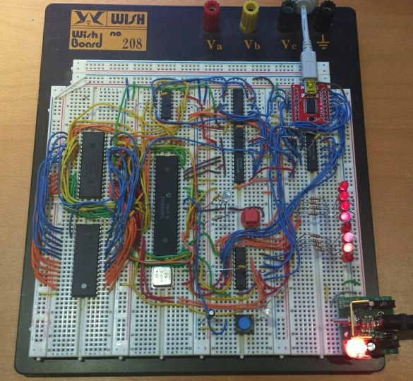

At http://www.bigmessowires.com/2014/10/29/68k-free-run/ Steve Chamberlin writes about free-running a 68008 on a breadboard:
Quote:
Along the way to this demo, I discovered that reset handling for the 68K is annoyingly complicated. You might think there’s just a /RESET input to the CPU, and you could force /RESET low to reset the processor, but that’s not how it works...

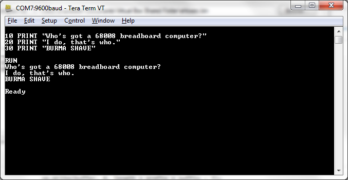

Steve has made significant progress, now running EhBASIC at 2MHz:
http://www.bigmessowires.com/2014/11/04 ... g-the-68k/
