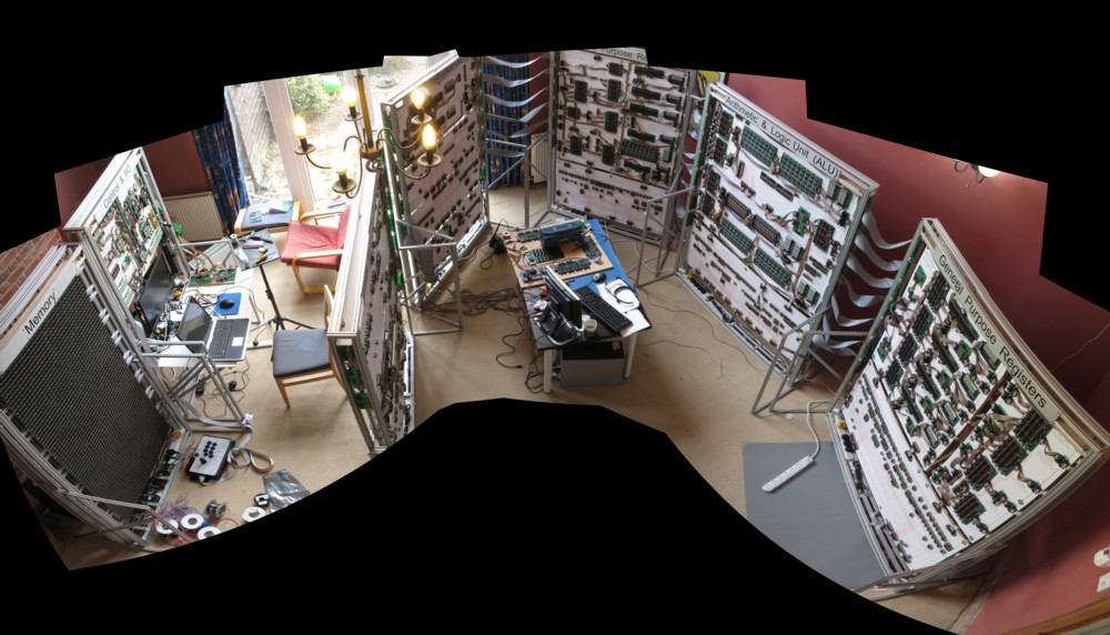

James posted an update with a photo of his room/computer:
http://www.megaprocessor.com/progress.html
Quote:
We now have the four right hand frames running together which are Input & Decoding, Special Purpose Registers, ALU, General Purpose Registers. With the current state of the living room I can't really show them in action. You can get some feel for the conditions from this picture:
via hackaday
